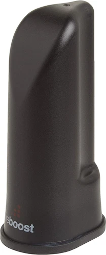

At work, we have several WeBoost Drive Reach models. They're 'okay'. If your phone isn't right on top of the transmitter, it's pretty worthless. I was very interested in a 'cradle' signal booster solution, but only I would be receiving cell coverage, and there is no provision for them to be used outside the vehicle while in camp (most of the time I actually need it).
