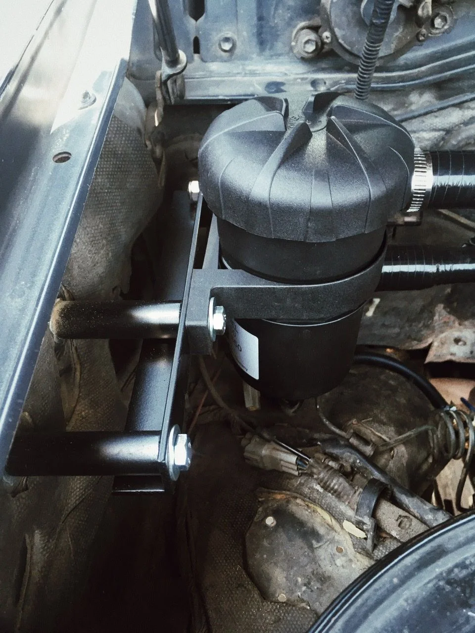

Installed the PROVENT 200 today. Easy job. Will continue to rework the bracket I made, but it will do the trick for now.8A2D4B06-2811-436A-A73C-3504757E90E7.jpeg
the old catch can... small and cheap.

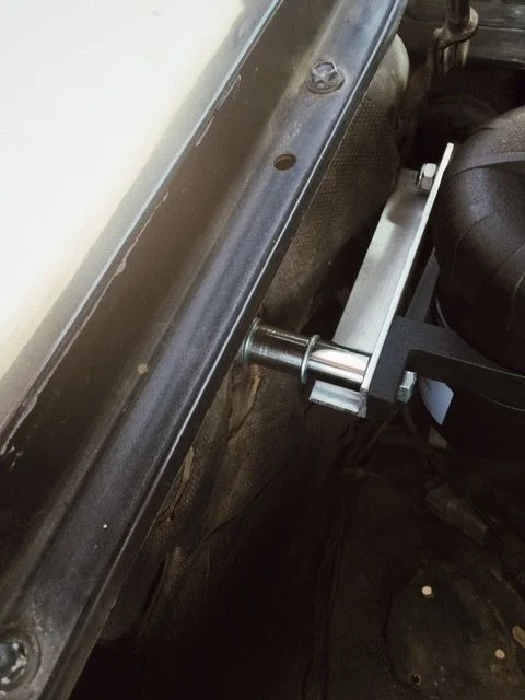

Reworked the bracket for the PROVENT today. Much much better.
old bracket:
