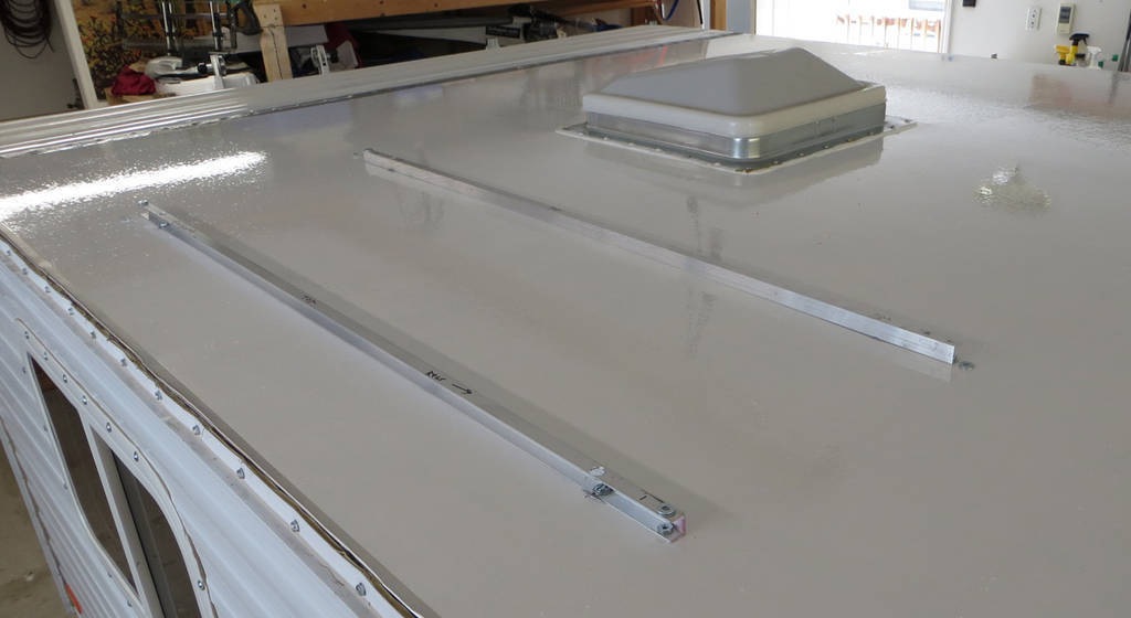

Trying to workout how I'm going to mount this solar panel on the roof. The mounting holes don't line up with the roof framing so I'm thinking of using two 1x4's to span the roof framing and using T nuts under those so I can screw the panel on with machine screws. Photo shows the panel upside down with a 1x2 and T nut on one corner. I'll need 1x4's for this because the center feet/supports on the panel aren't inline with the mounting holes on the ends. I'm going to run the cord down the corner molding on the rear and under the wing as that's where my power connector is now. This is a Sunforce 50123 20W Kit which comes with a charge controller.

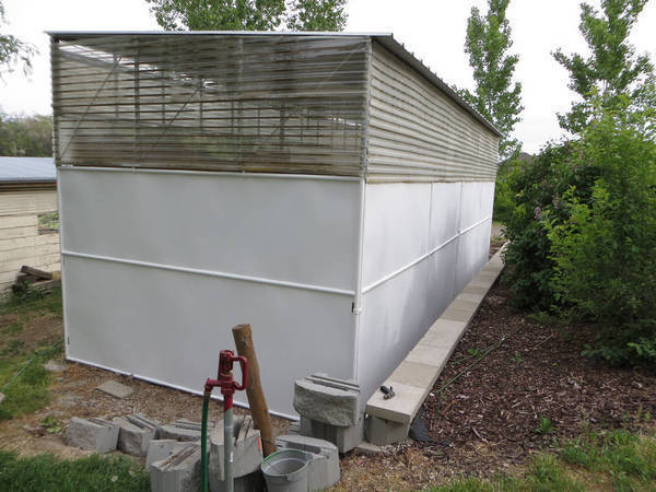

Painted the top. Used an etching primer and 2-part urethane top coat. That bare aluminum was getting hot in the sun.
Had some leftover primer from painting this steel building which was a virtual oven before it was painted.

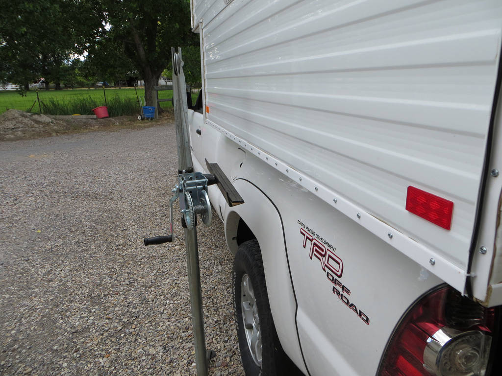

Question from a couple pages back, to "Launch Day". What type of system is that to lift the camper up to the truck without attaching anything to the trailer? Does the cable system go underneath the camper?
