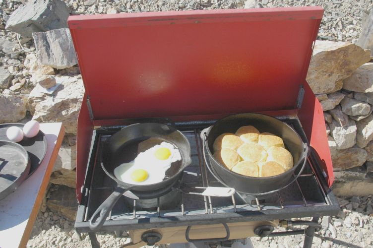

dcg141
First weekend of cooking. Very good stove. It will simmer just fine. Like most camp stoves the control valves are a tad sensitive but you can get the flames really low and consistent.
