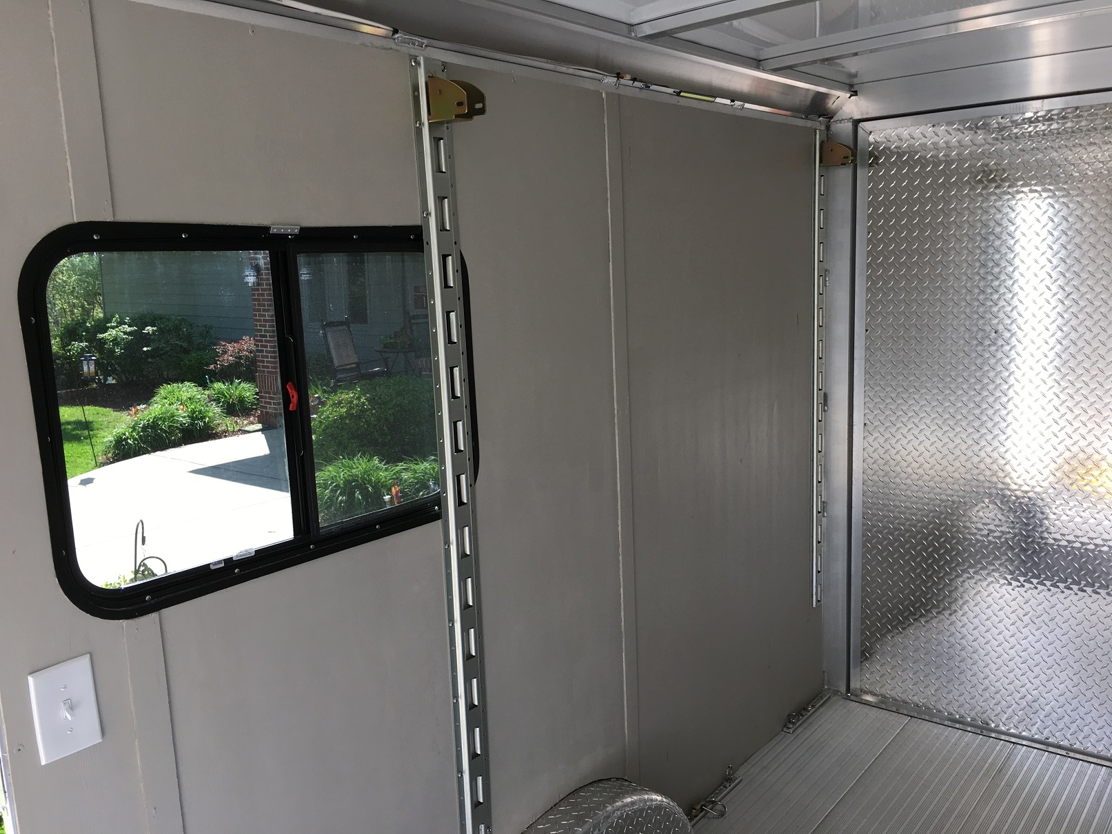

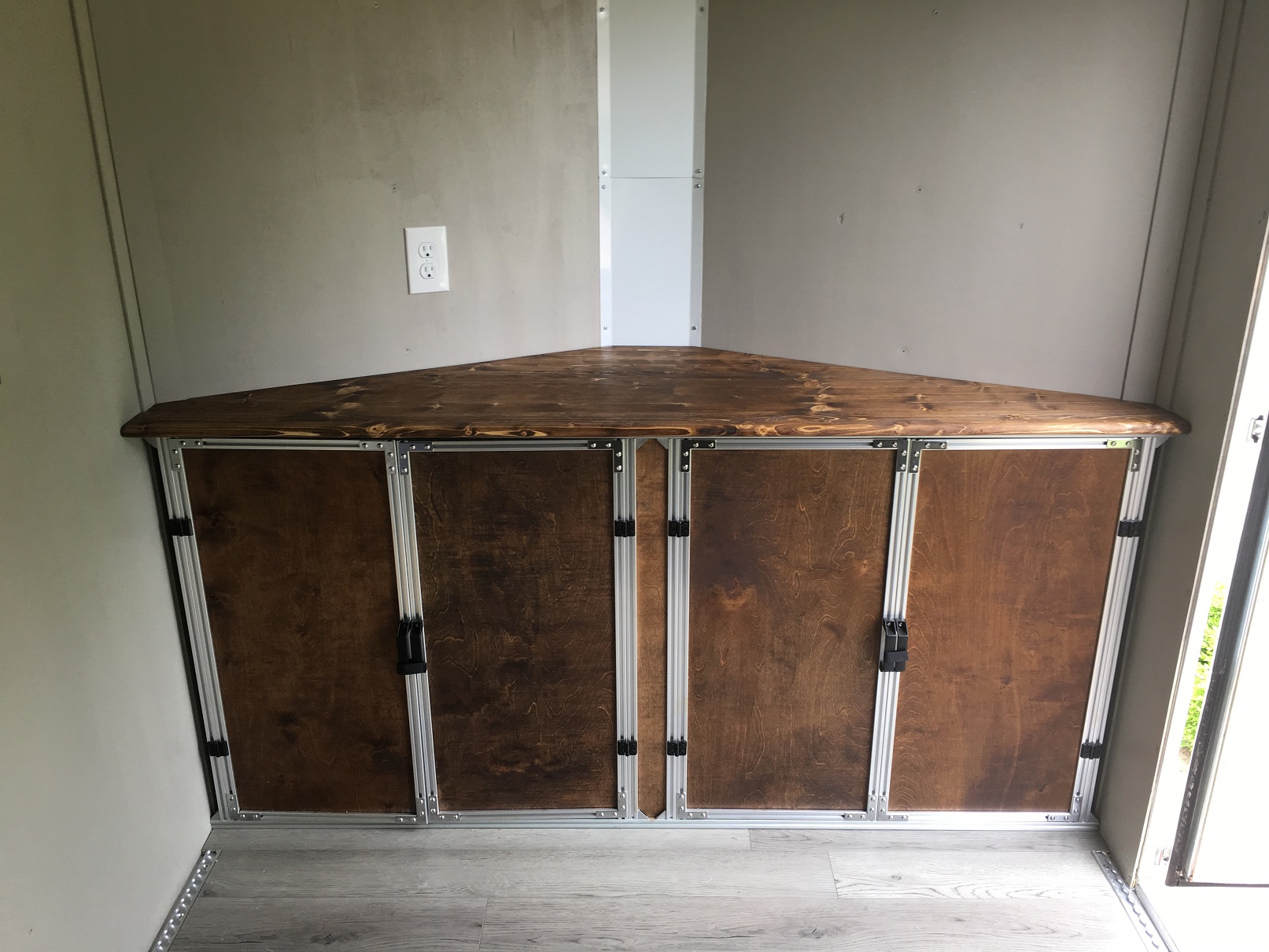

I have a Sportsmobile, but bought and am slowly configuring a 6x12 cargo trailer to provide more space and carry toys. I've slowed the build due to COVID. I installed vertical E-track for a bed platform so I can raise and lower based on cargo. Built a lower forward cabinet and will add an upper. Will have a sink in the forward cabinet, removable shower with curtain track in the ceiling, hot water, and Thetford toilet. I bought it 6" higher, so 78", and with a lift, 30 amp electric, insulated walls, A/C window port, windows, locking RV style door latch, and narrowed axle to match the van's track. L-track on the floor. I am using a movable Black Widow chock (it has arms that extend to the side) for my bike.
Vinyl plank floor installed:
Forward lower cabinet out of extruded aluminum:
