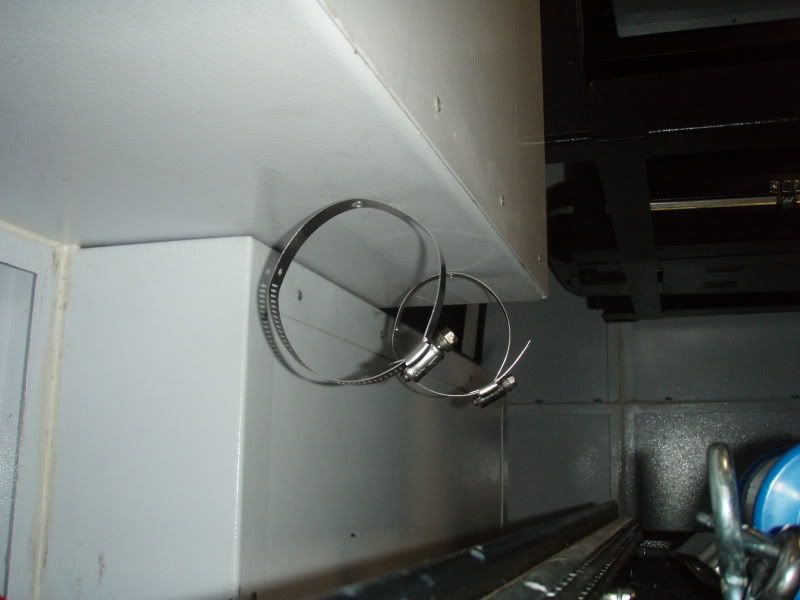

Filter has been mounted... This thing looks BIIG...
Brackets riveted through the wine cellar:
Filter all nice and snug. Quick connects, to boot!
