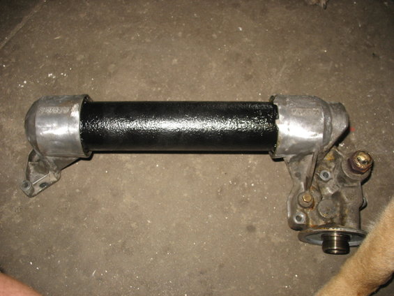

The factory block heater on every 7.3 Powerstroke is located within the "oil cooler"
The oil cooler is nothing more than a heat exchanger between the coolant and the oil.
Best picture I can find online in a quick search...
16151d1359828015-block-heater-i-think-leaking-oil-fuel-valley-2013-02-01_20-10-31_39.jpg
And a better look at the oil cooler assembly off the block. Notice the block heater plug on the right.
The heater heats the coolant which, in turn, warms the oil.
