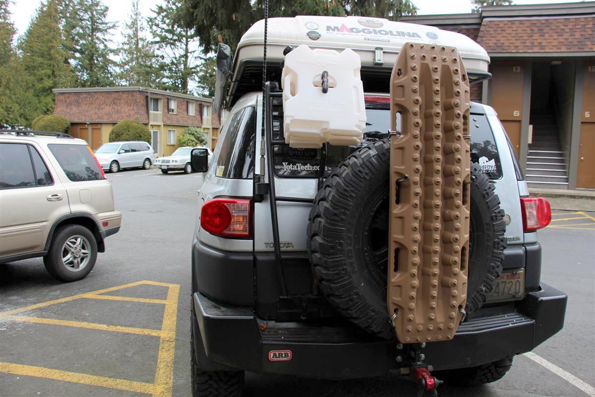

Rotopax And Ladder Mount Installed 1-7-2017
For quite awhile I have been trying out how to carry a few jerrycans of water or fuel on my rig.
Cannot put them on the roof since the roof top tent takes up the whole rack, and I do not have a swingout bumper to install a jerrycan holder on.
Last week I saw on Instagram a nice patch for a headliner (I collect them and install on my FJ Cruisers headliner) for Overland Equipped.
I had never heard of them, and I headed over to their site and saw they had a Rotopax mount that goes behind a ladder on a rig.
Well I have a ladder, so I emailed Matt from there and then talked to him on the phone and ordered up the plate, and I also got a sticker and two patches from him.
He told me what I needed from Rotopax, so I ordered up two white water only two gallon cans, the DLX Pack Mount, and an extension so I could add a second can.
Matt and I were not sure if this was going to fit, as I may be the first FJ Cruiser to have tried this, I am not 100% sure.
But as you can see from the pictures it turned out perfect.
The only thing is the cans block my Overland Journal oval sticker, so I will have to mount a new sticker.
The hardware Matt includes use 7/16" nuts, and most of my tools including my nice Craftsman ratchet wrenches I have in my home and rig are metric.
I tried a 12 mm ratchet, but a little too big.
Fortunately my neighbor had a closed end 7/16" wrench.
It was very slow with it, so I will now be ordering a standard ratchet wrench set.
If I had one, it would have gone a lot faster.
But I am very happy with the outcome here, I think it turned out great.

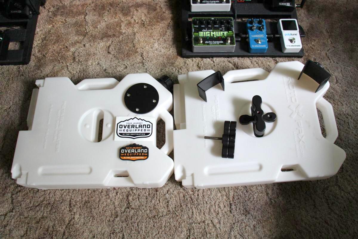

On with some pictures
All the parts spreed out with Matt's ladder mount on top of the left can
I did not know what those two plastic clips are, and Matt answered me over on Instagram that they clip together two cans if used side by side.
One can mounted, no T lock handle on yet
The second can will push in over that black part.

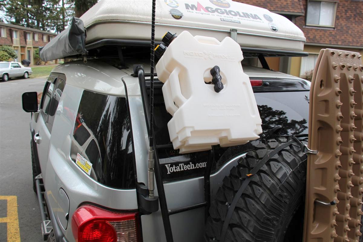

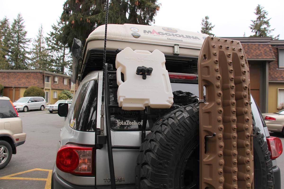

Both cans mounted and T handle turned and tightened down to hold both cans

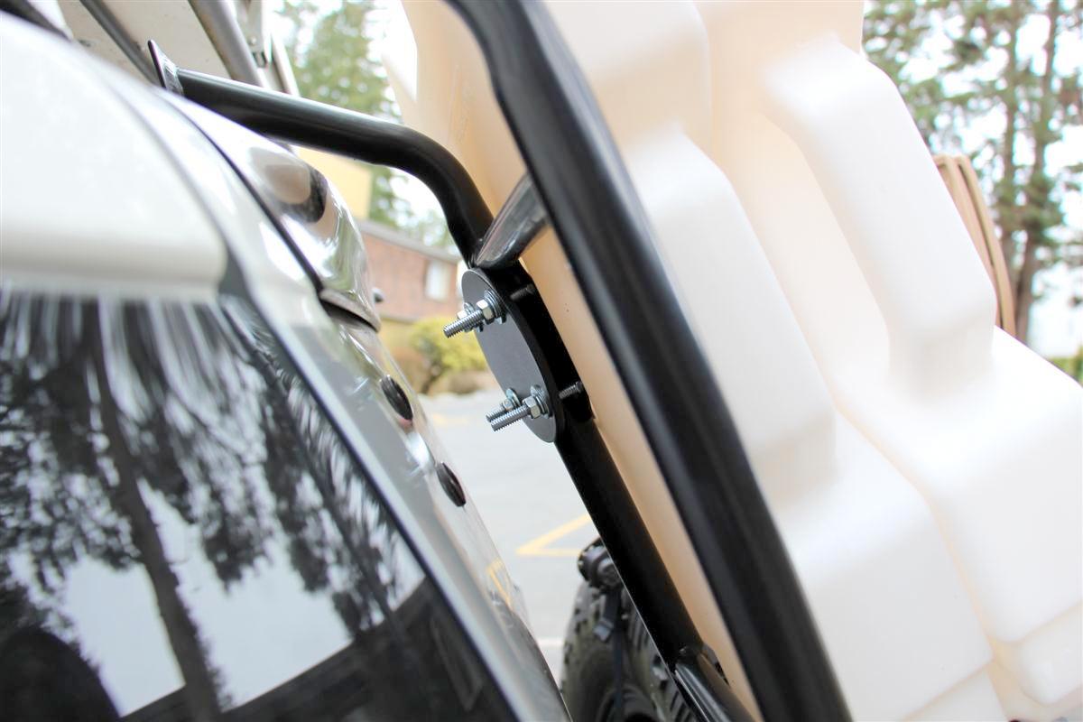

Showing Matt's round black plate on the backside of the ladder, it bolts to the Rotopax mount
Yes, there is some rear window blockage, but I do not really use the window anyways with the Maxtrax mounted there, and it is worse when the chuckbox is loaded in the rear for a trip
