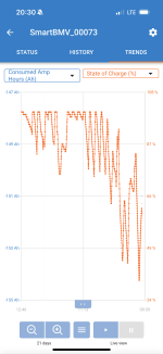

This is my power map over 21 days of camping in the SW, you can see the large draws toward the end when we actually had to run AC all night. We didn’t use any campsites so none of this charging was from shore power rather solar and driving. Towards the end of the trip when we weren’t moving inside Big Bend very often we didn’t recharge as well so we did start to get closer to running out.

Can you help me with that graph ? I understand the SOC data points, is it also showing consumption of ~150Ah / day ?
Assume 12v so ~1.8kWh. If so that sounds reasonable seeing as some are building campers with 8kWh battery capacities etc.
I’ll have to see if I can make a fresh chart with the old data stores in the BMS. That was a screen shot I had on my phone from going over some details with a buddy who was looking to add A/C to his 4wh camper. I believe the information you’re referring to doesn’t show on the scale of that chart. I think it’s a separate blue line that’s not visible.
I did look back through my phone and found a few other screen shots of power consumption while running the AC and showing how much was used over night. I’ll post them here.

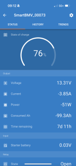

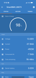

This one is showing current consumption with the A/C running full blast in a hot camper. It’s drawing about 500W (you can see Voltage and Amp draw on there too if you don’t wanna do the math). At full tilt it shows 9hr and 44mins of available run time with that load at that temperature. The draw goes way down as the air conditioner goes into eco mode once the camper is cooled and of course as the sun goes down and the night air cools off.
This second one shows usage after a full night running it. Used just about 100Ah including a Fridge and internal lighting. I have 330W of solar and a 100/30 MPPT controller which obviously won’t keep up with such heavy usage.

Good info thanks. I read back and see you mentioned having 400Ah batteries so from there SoC has additional meaning.
