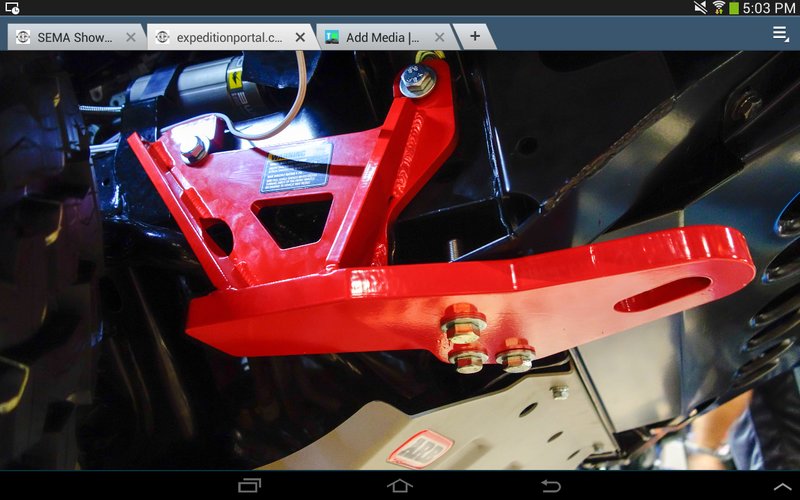

If anybody is interested this is how nice the P&P recovery point plays with an ARB bumper. Next to it you can see a P&P radiator skid that needed a bit of nipping and tucking to work with the ARB bumper. Dude got pretty salty when I pointed this out, then gave me a great discount on an oil pan skid. Also have sliders from them that are pretty OK.
