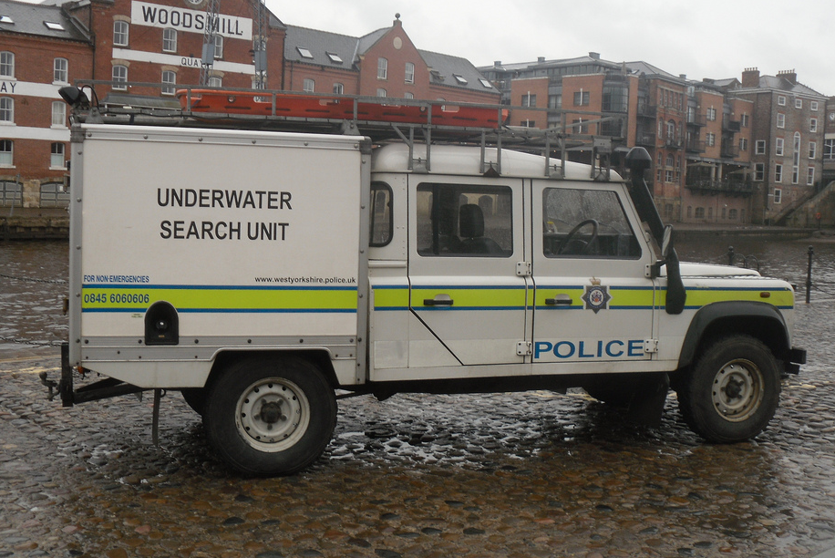

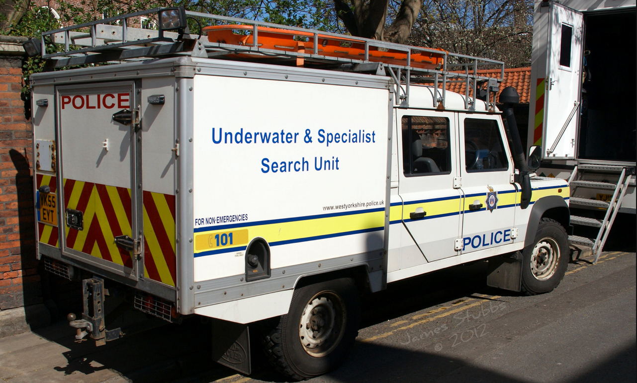

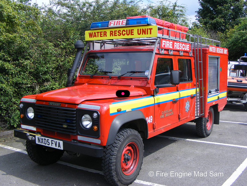

We have a Land Rover Special Vehicle Quadtech 1 body that we are going to mod, and use for a while until we can afford what we really want.
I spoke to Land Rover SV department today ( who were very helpful ) about a number of things relating to these units, my main question was the fitting of twin roof racks, and the load rating for the racks, they advised me that a full length rack ( like the ones in the pictures below, these are LRSV ones ) will take 150kg, I was looking at fitting 2 single Patriot racks, and having our roof tent on the rear section, however, the rear body as internal fixing point that the rack needs to be fixed to, I am unsure if the weight of a 1.6 Hannibal tent 65kg empty will be ok on this part of the body?
By the looks of all these pictures, theres 4 mounting points on the Quadtech
