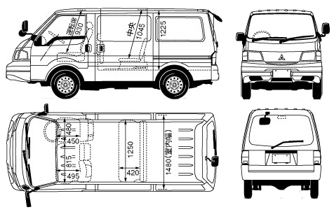

anyone know the interior dimensions? I thought I read awhile ago about 7ft from the hatch the the rear of the driver seat, no idea if thats correct. but my bikes about 3'9" long with no wheels, and 5'1 with a rear wheel. if 7ft is correct, that leaves me just 3 feet x the width of the van for a little kitchen area and whatever else. not much but I could maybe make that work, especially if I got creative with integrating stuff into the platform/storage area, and/or got creative with folding stuff.
Other option is to do a fiberglass high roof, and build storage more vertically.
If I can find the interior dimensions I think that will really tell me what I'll be able to do.
Sabre
Overlanding Nurse
...If I can find the interior dimensions I think that will really tell me what I'll be able to do.
Dimensions are in millimeters.
Haf-E
Print out the diagram, look up the overall length in the specifications and then scale the drawing to allow you to make the measurements - i.e. if it is 15 feet long and the length from the rear hatch is 50% then that would result in it being 7.5 feet.
brad2274
using this highly scientific 420 method, im guestimating 5 and 3/4 420's, or just under 8 of the kings feet (7' 11" is my guess) and thats not all the way to outside of the hatch, i was guessing its like 4 inches thick
Sandy89
Ahh thank you! if its around 7'11" at all that sounds pretty decent. I feel like I could make that work. after sleeping in sedans and wagons for so long thats a huge step up!
