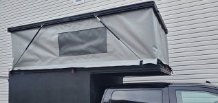

First of all, the camper had to be Light Weight due to the limited weight capacity of the truck - Limited compared to a 3/4 or 1 ton. As such, materials like Steel, Wood, etc. were out, Aluminum was what I chose
Second, this had to be low budget.... ie. much less than it would cost me to buy a project M, or something similar (so under $10,000cdn)
(Oh, and I chose to do a popup to save weight and keep ground clearance reasonable).
I was doing a ton of research on building with aluminum till I came across this build thread where @97heavyweight built a camper with 8020.
It was more expensive than aluminum but since I didn't have a way to weld aluminum, 8020 seemed the way to go. But what really sold me on it were the free tools I found!
FrameXpert and the "Tech Toolkit" from 8020!
Why was the Tool Kit critical to me? Because this program gives me the ability to do deflection tests for the cantilever part of the build with various loads and lengths. I wasn't able to find anything like this for boxed aluminum, so this pretty much sealed the deal for me choosing to go with 8020 style extrusion.
I started my design with the cantilever part of the design and worked my way from there. Using Tech Toolkit, I figured out the loading and what I wanted my maximum deflection to be.
This gave me the profile of 8020 that I needed as well as the length of the cantilever. from there I added supports down to the truck bed and enclosed it.
I went with a flip or full-width access door for weight and simplicity. I also designed this so I can take the tailgate off, enclose the back and put in an RV door if I so desire.
I decided to run a support down to the truck bed to take some of the weight loading off the bedsides and transfer it down to the truck bed.
Lastly, I used 1.5x3" for the roof to give it rigidity and braced it with 2 horizontal supports. If this ends up being flimsy, then I can easily add more support. Another benefit of using 8020.

The next step was sourcing the 8020. This proved to be a big challenge as I am not located anywhere near a big city. After an extensive google search, I came across Faztek in Canada.
www.faztek.ca
The pricing was better than 8020 and the shipping wasn't too bad. Plus they had black anodized extrusions in stock, which I was a fan of especially since that didn't cost much more. But the big drawback aside from the shipping costs, was the fact they only shipped up to 97" lengths and I needed 110" for my main support beams. So, after a lot of thought, I decided to order the longest continuous length I could and then use a ton of butt joints and plates to secure the pieces together. Not overly happy with this, but there shouldn’t be too much force at that point of the frame as I have a support leg placed before the joint (This location will vary and I might even change it to a 1530 support spanning the joint.
From here I will be siding the camper with .040 aluminum, mostly because I cannot find ACM (Aluminum comp panels) anywhere near me.
I will be using 1/2" or 3/4" plywood for the sleeping area and will be custom-making a 6" foam bed to be full width and 80" long. so, somewhere between a Queen and a King mattress.
I do have a removable panel that supports approximately 3 feet of the bed that can be easily removed and pushed to the forward part of the camper when the top is deployed. This gives me the full dimensions of the bed as a living space when not in sleeping mode. I am planning on designing the foam here to be used as cushions on a bench or seats below.
The interior will be designed after the camper is built; I have designed this camper to give me the max amount of space for the least amount of weight so the interior will be determined after the shell is built, the truck is weighted and I see how much axle payload I have remaining.
