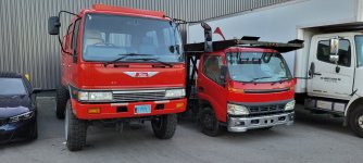

And because a post without pictures is boring... found a little brother in town, lol.
