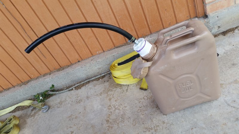

I needed a scepter gas can spout but didn't want to pay the Amazon premium of $20
Figured I could make my own.
I noticed the threads inside the can spout opening:
Went to the hardware store and picked up a 2 inch male adapter, 2 x 1/2 threaded bushing, a barb fitting and some fuel hose..
Glued the fittings together, threaded the barb fitting using yellow teflon rated for fuel:
Voila:

With a little care and a chop or table saw, one could readily remove say 2/3 the height of those couplers and greatly reduce the size / bulk of that device.
takesiteasy
Here's some pics of the one I made. It works well. The internal vent of the MFC alows it to drain pretty fast but I haven't timed it. I used 3/4" i.d. tubing and put a 4" nipple on the end to fit into the filler tube of the truck. I bought caps for each end to protect the threads. I also put a screen inside the tubing for dirt. I got these ideas from a different thread on here from some time back.
