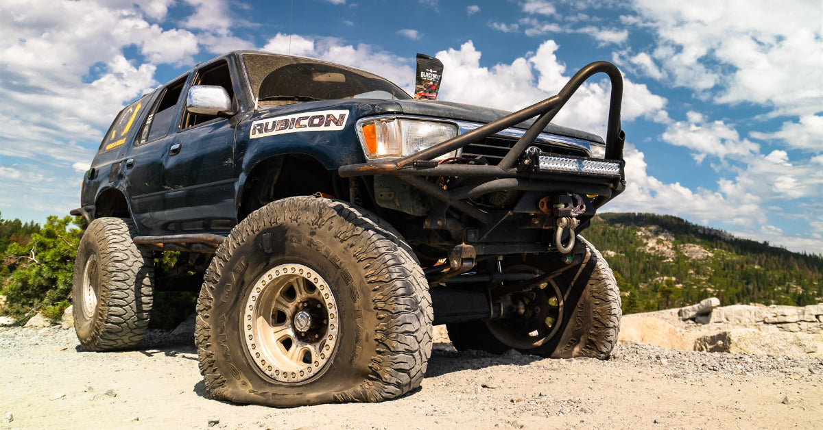

I've ripped out the sidewall in the White Mtns. On the Dusy a member of our group ripped out a sidewall. Without a spare we'd have been sol.
