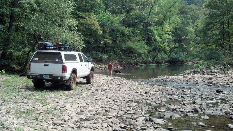

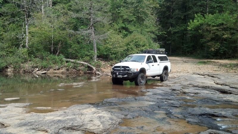

have owned and abused my ram 2500 since 07.
off road, it's never left me stranded...
but it's like any off road use vehicle, maintenance is vital. hubs, front u-joints, ball joints, and steering need constant inspection to catch issues before they are a problem off road.
engine and transmission have been bulletproof for over 220,000 miles.
rust was my only major issue that needed repair...
finally got her back together and it did great spending a week out in the backcountry...

Great looking functional truck Tex. If you've got the Carli setup with his rear leafs,that thing must ride real nice. Super improvement over the minipaks.
