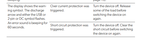

Anyone else have a short circuit failure on the USB port on the Dometic PLB40?
I have been using mine for 4 or 5 years flawlessly.
Tried hooking up my Uniden SDS-200 scanner and raspberry PI 5V usb connector to the Dometic and it went into fault mode.
No fuses blown...short circuit triggered.
Been running this same setup off the 12v lighter in the Jeep for several years now.
The Dometic normally powers my Engel fridge 24/7 and when its in my Jeep it is recharged via Solar...been doing this for years. Additionally it was keeping my Blackvue Dashcam Battery recharged when connected to Solar.
Screenshot at 2024-02-02 19:27:01.pngplb40.jpeg
when I first purchased the PLB40 it had no problems running the SDS200 so this must related to the USB ports.
IMHO this should not have short circuited the PLB40.
this configuration is running via 12v cig lighter on my truck 24/7.

Dometic is sending me new USB ports. I think.
nope board is fried where the USB connected.

Which Raspberry Pi are you using? The RPi3 needed 2.4A (12.5W) from it's 5V. The RPi4 and 5 are 3A and 5A. The Dometic appears to give you 2.4A per port and total of 4.2A, so you're likely right at the spec limit. It'll depend, too, what you might have the RPi doing and plugged into it.
DaveInDenver
Middle Income Semi-Redneck
It’s a custom built head unit for my scanner. I’m guessing it’s a 2 or 3 Based on when I bought it.
That site is from 2021 and mentions USB-C, which implies it might be a RPi4. The 4B was released summer of 2019 and needs 3A to meet all specs, but 2.5A is the minimum as long as the USB peripherals do not exceed 500mA.
