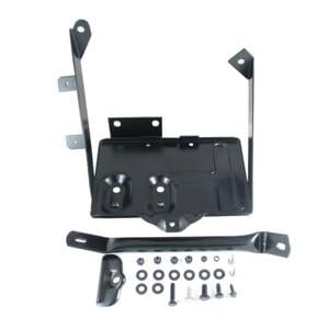

5. C. look into installing a battery under the battery by the frame.with something like this:
[ame="http://www.amazon.com/gp/product/B002Y33602/ref=pd_lpo_k2_dp_sr_2?pf_rd_p=486539851&pf_rd_s=lpo-top-stripe-1&pf_rd_t=201&pf_rd_i=B001O0D6R4&pf_rd_m=ATVPDKIKX0DER&pf_rd_r=0P9E9VF3Z18APY518Z1Z"]http://www.amazon.com/gp/product/B002Y33602/ref=pd_lpo_k2_dp_sr_2?pf_rd_p=486539851&pf_rd_s=lpo-top-stripe-1&pf_rd_t=201&pf_rd_i=B001O0D6R4&pf_rd_m=ATVPDKIKX0DER&pf_rd_r=0P9E9VF3Z18APY518Z1Z[/ame]
If you cannot easily water the battery, get an AGM.
