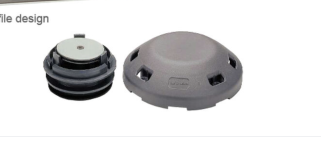

Sure, I’ll try to describe it. From the website:
It’s been 3 years, but as I recall inside the outer dome part, there’s a 3” OD tube that goes through the hole you drill in the wall. Then, the internal plunger is inserted and rotated/clicked into place with the light grey disk to the inside of the camper. That disk is the reachable “handle” on the plunger that you pull out to open the vent to air flow and push in to seal it. Literally everything is O-ringed and gasketed. The way it fits into the outer part there is actually no way for water to ingress, it just drains around and out the slots on the rim. These are meant for flat. mounted overhead boat hatches that are hit with spray all the time. Even open, water cant get in. The air is drawn through slots at the very top inside flat part of the outer dome piece. I really never close it, even when washing the rig. It also helps vent heat in Phoenix and especially on the road, which is important to me in the heat and on the highways with a closed camper while traveling. It could also be roof mounted and it might get better pressure that way.
Yeah the Dacron filter material just filters small bugs and dirt. I clean it about once a year. Gets very little dirt/dust from the road where it’s located on my rig. The Dacron and the spring clip were added by me. Also, the internal white trim flange not shown above (but is in my last picture) has a 3” snug fitting sleeve that fits over the plunger component is quite long and can accomodate a really thick wall. I cut it down to a couple inches for my build.
I doubt it provides lots of pressure on slow speed dirt roads, but for me the most dust is while on washboardy roads where I’m going 20-40 mph which is plenty wind pressure on the vent. The square back to my camper really crates a vacuum and coats the back with fine dust. The vent cuts the internal pressure well as far as I can see. Most all of my limited dust inside comes from wind with the camper stopped and wide open and from me blowing the loose dust off.
And, as you say it’s simple.
