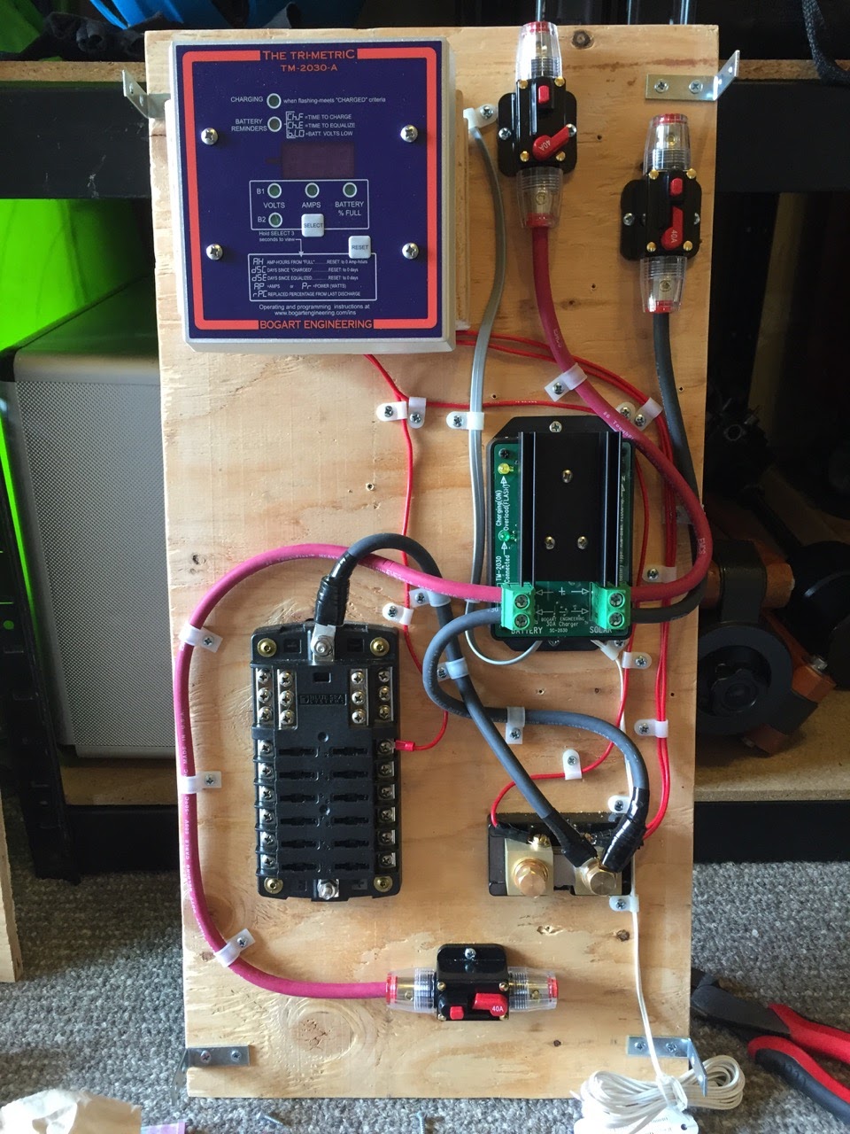

Wiring up the solar charging and 12v panel powering a Universal Power Group, UB-8D AGM, 12 Volt, 250Ah battery that sits inside one of the boxes in the back.
mZRmi1OYLRZv1rBzA41eSkLS4Hc0I1YvWGDKAqS5cq07hMO7D8wotHJgp9HPizxnV1oYw-F7oKQmzxnxvzy1B7C-RDvj62IPcYxxyGGhWPgCT2oD7BAYw3JIBon-VMQ050X1fO34pxERrMqVw7ixRzsE_0wdVfmpuqNP_k-l3W5vFO6E2nnq8y45xVP49T0fHRKMeyzOqQaANxmTo4iO2sF1YcFI6Vd15lhMlWFCifocfcrVNmqbkDTdUzWpuVtzBrRSTjh15wUyunk1CrTwweKr1wiy5ykBwjg9YCtlnjijTv12fCKezuBJZ0sjX5w2wetKgfp7u97IBlwkDdwYHNNHlpYmocuIt6Z-1RUsF9bWdkL4sO1sclqaBYw-9LKJbVd5baSJCtgF2Qg0WEfX6TFclema9c5bAu1e2uZjvOR8j-chOBAWwUJahLwrB52cqKNze38A7GL7HwqlKipOhvqtFQY_9dfR7QT5bG13j1lWExSz7dZa0_n0VPhH2NayK5IEmLOxAeD3IpCw0l0GChhsSVtnoCP333q8a6KhpkJM9x_QisAtn9zePkPJrvlimZucFMMrIk9RFHHYvTPx7I7de5cm-lRfisUsywo6TJc6Lyb0RsGNsBR7QQN_x9-DHqI1_i5o6KFGlY07UC9tNV5lksFK3hyP3i341J304w=w960-h1280-no
150w Panel on Vantech rails.
Iiz3-6x8mJegP2Za4J_TbZhmOb43Kgdmy3atrhugcX4DdTgz1Xe-IaRulOkcWyprOI5FyRpJX_MYury8gk8bNFPewWj2riAYV0mks0fPfR52_HKl7DwNB3uUG7OgDkGV4BCWXHJekEmeDbuOuw4qryFfTWS-NsM8duDSKeriBi0Rcr1VE-1r7BqeH8nd7ubv4f5e7rfV4PAdZOFYSu-PKSOf7TxoufWbgw-g3He6R2Xh-YuPGfsQEjloHwVFtv6xHj9fY8-cTWzxKvd-e74fSUt6kscVztKYrsGEem6xZ_54fmJl7qr1LFw5Fya5S2HA_hSkvxoGVmlkofX_e53s9tthfIplkZa3roD4vZM13YkmxtIwJ1tk4KwxPkP8pKCebZ2Gol5dGehbLL6htqObdvynnn9yLzrvAihjgM5O_Een7CLiwPqCwFoyKnTcpUmIu44GCC1VAQK58uwb77mvf05gG32JX2hnTMI-Tt_5h08C5AF-fy3Y6DApj7rtqao91bpMBuetYOcBy7o68WSP2JHqij7JCeANsAFNIAGzVmo_Ol7pRopUZ98uyYV0gDOBAjvu_wcTtydwgdt0OZ0PJnUv5_Mpbk-DOWq0DIcA5t44PoxKvwLAbT0TNYOALkm9LR-Kfoln-9dQlGkNDoPgMWT4tsrNsm8SiMZMGioSug=w1280-h960-no
All set up with room for more up top.
DWFrbxBwzUW_X7DI0qMat2CCg-cv3V9B6aa-1R64mEICBlT4iVrQfCzIhW4tTTskcbYCwqi6_eLWB14M99cqeTrP1TCEdEAUuXGAewjm4pg8vObimXawAy0-C3WI8OcBZ-1mt8YOv05lYI2l6MAuno-8cfgdrkvgFqwADgrEN7koUQIQuvKX3hdsvN9vqvQ1gI9IPcBDyrb10ezzeeTHJg_NG7x0qfNJQaRKRnZA8HFYYY3lFmgOrQYCIQKlLRfbfJDqZE1mNkXqO_8Gx4ximdlziOT_g2TZ-y98iwNBVsOIs8L0LT8OhVX6xuvdSWo6V9JOC8Ksa-OlOBvjuQ6ykAdwX5kv4vWEtoWdOlWM6lY_X3eUAufK8lNqHXSScuKWiAocRbMVP7bCUQulR8nzx9UHcDyM9dlbqOuGYmNvP0UN3bivvI5FH29Q70k7zDh4-Ybv0iD35ENVROnpN1HGOzphL4G0yW1GErGOES-WWT2VwP-SJmhDWwwpdVdLjKsaHdfaj8YBH-d9XkjlP4orBXFKdW1lDrT0Y0yhyN4K9R-5nnYWkhJcG58uXmlxuNomm6QqxlLkLQaLlRAQP4wUqgbm5l2H2rPgyWuHAuFPx6CaJ8Vf6E43VrXKi5bASbMjd8kt2pE8lqiX5xSUg8CiALvR34ndWSMYyAUL9xw7Pw=w960-h1280-no
Solar power panel - could be improved but that's what I came up with.
