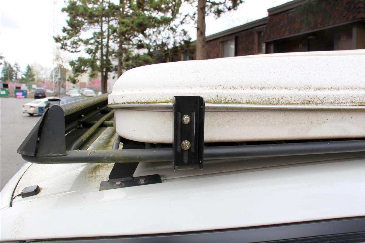

I think you should contact Greg at www.gziladesigns.com and see if he can get something made to work with your rack and awning. I agree, not getting contacted back sucks, and is generally bad customer service. I have nothing to do with Gzila other than being a very impressed customer of his, and I think he could probably solve your clamp issue if he has time. I bought my ARB awning and their mount kit for my BajaRack, and while it mounted the awning just fine, it obviously wasn't meant to be used with a RTT since I couldn't open the window on the awning side. Greg made some clamps for it, and not only do they look great, but they work exactly like I needed them to.
These are the awning brackets he made that fit my rack. They came powdercoated, and the fit and finish is far better than I expected from a guy who was just starting his own company at the time.

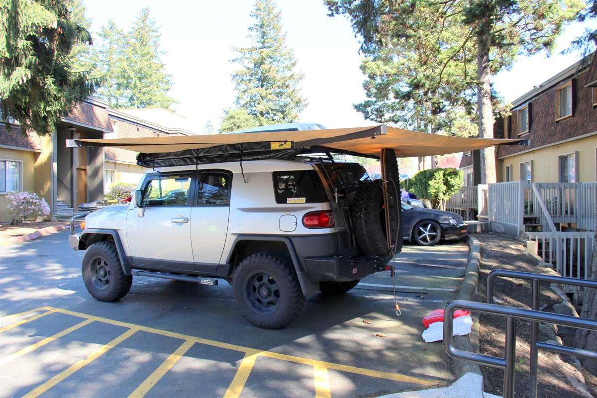

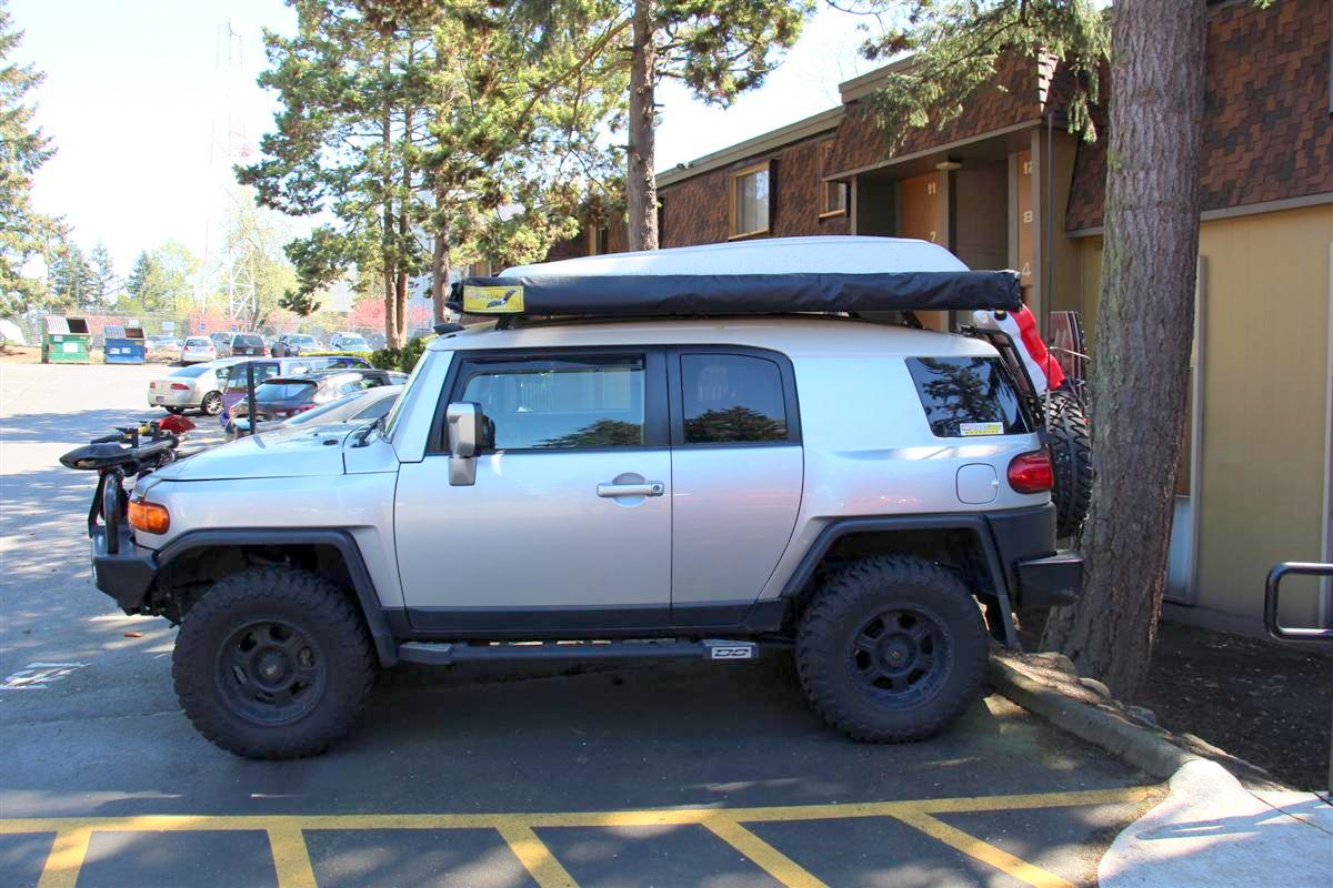

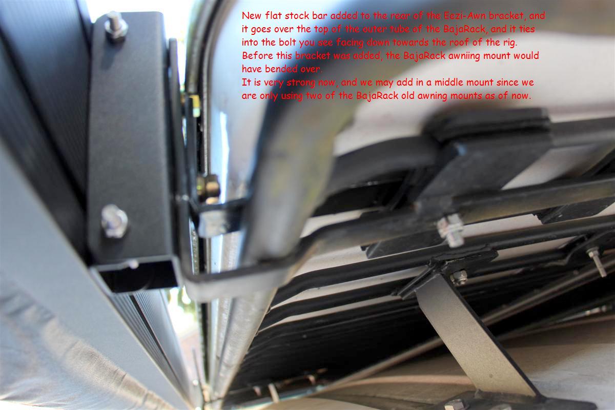

Being a new Eezi-Awn Bat 270 owner, I m very happy with mine so far.
It was to heavy for the stock BajaRack awning mounts that I had used for years with my 20 lb campinglabs awning.
The awning would have bent over the Baja ones since it is close to 2.5 times the weight of the Campinglab one.
The shop I deal with was going to weld some gussets in there like you see on rock sliders, but they came up with an easier idea right in the shop by making a bracket that tied the upright part of the Baja unit to the lower part that bolts to the Baja roof rack.
Look ma, no poles
