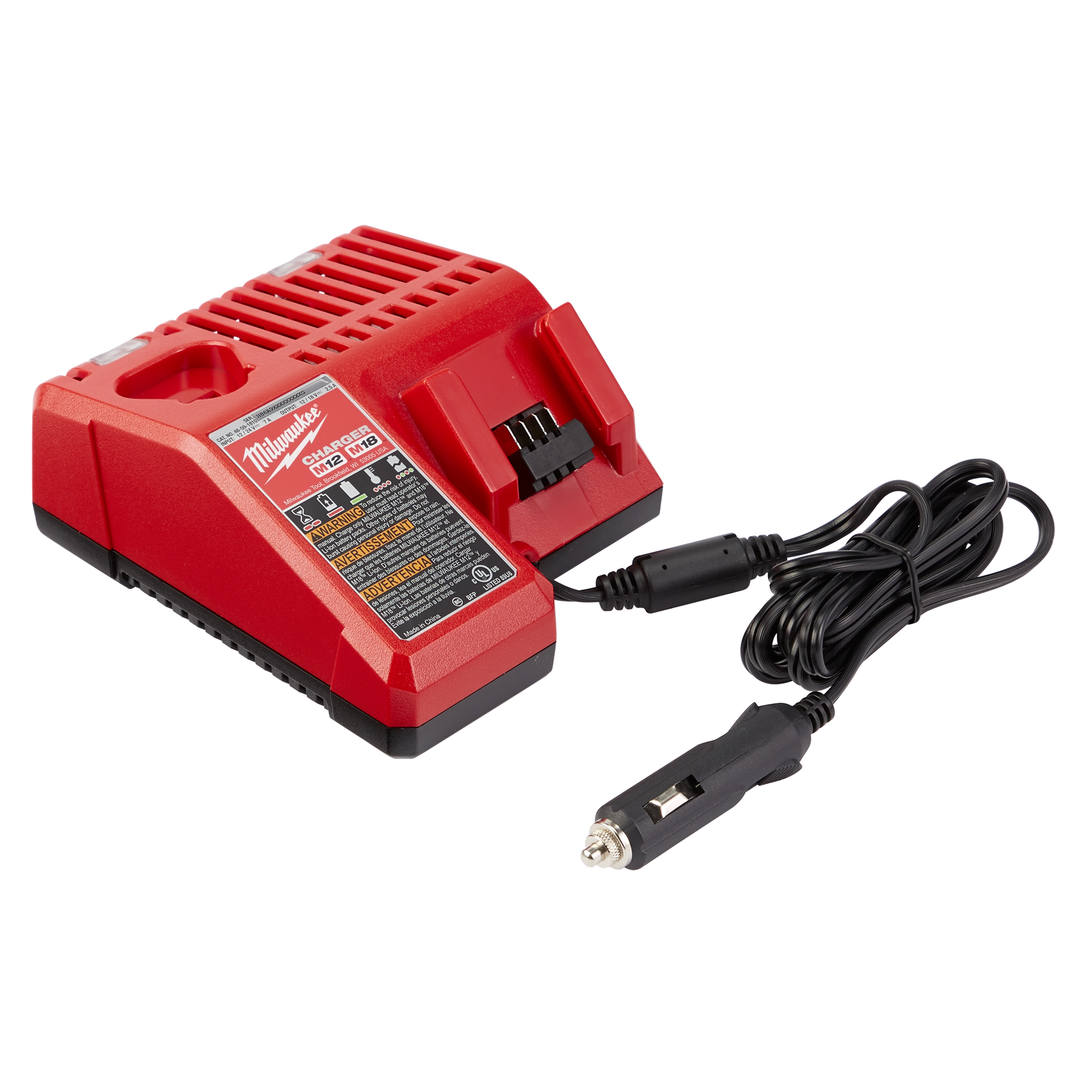

What are the wattage that the battery charger requires for these chainsaws ? Trying to size an inverter in order to charge these chainsaw batteries. Are there any 12v charger for any of the battery powered chainsaws out here ?
Hard to make the electric juice go from 12v to 40v without a inverter?
clydeps
It's actually pretty easy. Going from 12VDC to 40VDC isn't inversion (an inverter converts DC to AC.)
But, while there is no technical reason why a lithium powertool battery couldn't be charged from 12V with a DC-DC step up power supply, there are practical difficulties - e.g. charge control (does the battery have a built-in BMS or does the charger have to do that?) and the physical connection.
So homebrewing something would not be simple and from what I've seen there are few, if any, chargers available off the shelf for these kind of batteries that run off DC.
As far as what size inverter would be needed, as an example the EGO standard charger apparently draws about 200 watts and the fast charger something like 600. The standard charger would be a better choice for off-grid charging.
I use the "upgraded" Ego charger. It draws 450-500 watts for approx 40min to charge one 5Ah battery.
You'll need a min 800w inverter if you use the upgraded charger. When I try the Ego charger on our 600w (also have 3000w) the fans in the charger don't come on.
I've been using Milwaukee's car charger with good success.
I've even verified I can charge a battery with my k-tor pedal charger. It's real slow, but it works.
Also having very good luck with the Milwaukee inverter around camp
And I've been testing their M18 power supply to power low current 12v gadgets like the Weboost. Pretty awesome. But if you exceed a few amps it wrecks the power supply (not the battery).
