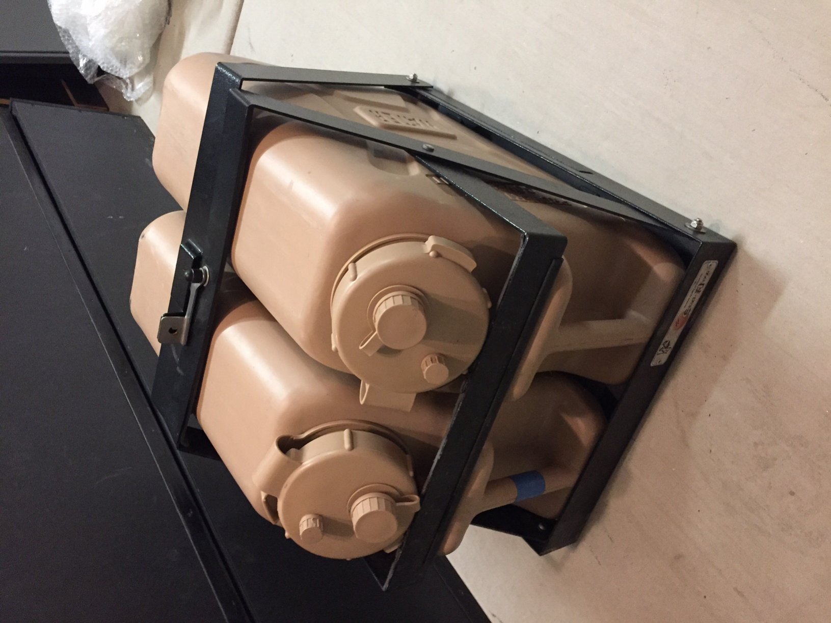

I bought one of the used dual can mounts/holders, strictly on a hunch that it would work with MFC and MWC, even though the internet pictures are sparse, and I was told the new style dual holders won't work.
I can successfully say that it can fit 2 scepter MFC cans. I cannot remember if the strap goes over the lid or not though, thus securing the fuel from being siphoned. It is stored away on my shelf now so I can't easily put it all back together to see. What I remember though, is that it was totally good enough. The cans themselves were secure, tight. I think the strap touched the side of the lid, therefore binding it up some. And furthermore, for those to seal you have to use a JAGMTE wrench to give it a little extra bit of a turn (I also have the JAGMTE one peice aluminum cap flanges - awesome product and NO leaks ever, period). That makes it impossible to open by hand... and secure enough for me.
Also, two MWC cans will also fit, secured tightly too. The MFC and MWC are not the same though, and the strap cannot fit over the pour spout. So there is no way to secure the water contents from the small pour spout being opened/siphoned. Not an issue for me. I do have a picture of this one on my phone and will reply from it with the picture.
What the K-9 unit cannot do is fit one MFC and one MWC at the same time due to the different shape and size of the lids and handles and angles. It will not securely hole one can, so got to take the other empty.
I am just glad to finally have a dual can mount that I can use for either fuel or water, that folds flat when not in use. I think I will have to drill some holes in the base to use it on my frontrunner, instead of using the hook/clasp mounts that it comes with. In my desired orientation, with my cans in place, there is no place to attach those hooks to the can holder base that don't interfere with the can and also align to the 8" on center slat openings.
Hope this helps you all. FWIW, I have no idea why this picture loads sideways, the raw image on my computer is correct... oh well

Hey Everyone. Great question Herbie. The Jerry Can holders do have that strap to go in front of the typical Jerry Can cam lever latches, and the holes that they put in that strap in our latest generation holders are for those interesting little red caps you see in the images you saw a couple posts earlier. That's great, if you have those little red caps. I have them on a couple cans only. Without them the strap drops down too far and with the the CARB compliant cans the only way to keep that strap in a secure place is with the red caps and holes.
Please remember, these can holders on this sale are the first gen holders. They do not have the holes in the strap. Only the typical NATO cans with the cam lever will be secured. Also, the big difference here is that these early holders did not have the interior diagonal supports that the new holders have, to wedge the cans together tightly. NATO cans do shift back and forth a bit in these. The solution is a 1/2" thick 1" wide piece of hard rubber glued in place inside the tray on both side where the taper of the can edge sits. Easy stuff.
Thanks for sharing the Scepter can fitment. That is cool to see.
