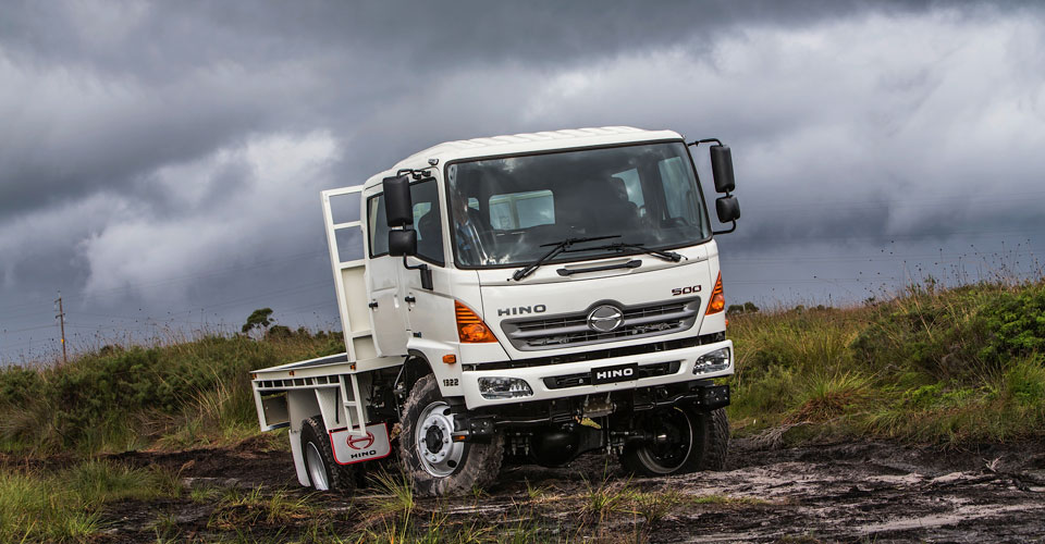

https://www.hino.com.au/500/4x4/ The Hino 500 4x4 bare frame would be a good starting point. (Serviceable world wide.) Add the coach of your choice. Should make a good world traveler.
