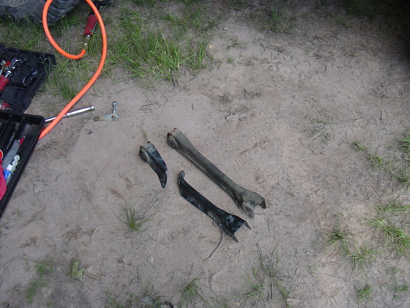

Off topic, but I wonder if you could easily "box" that arm for strength or are the ends weak too?
why? they were designed to twist and give. if you box them in the only give they will have are the rubber bushings and you will most likely be tearing off mounts next. much better to either upgrade to a better control arm that has johnny joints at both ends or twist in the middle like the JKS or simply acquire (usually for free) stock arms to carry as spares.

Root Moose
Not a fan.
The way the stock arms are so "plastic" the welds will be popping apart with heavy wheeling or there will be cracks forming at the ends because you have introduced a stress riser at either end of the welded plate.
Control arms aren't big money. Stop being a cheap *** and do it right. ;)

Not a fan.
I'll 2nd that in a less harsh tone :)....
mine had a small stress riser created by the 1st gen of the Airock sensor attachment points. You'll notice now that Steve won't sell you those...
Building another Jeep like the one here (33s on an LJ). I'd probably just grab a set of RE bushing arms and leave it at that. The only issue there is that they tend to be a little longer (1/8" I think) which can screw with the caster a little up front.
if anything though. The nice thing about a 5 link is that you can drive home with one of the CA's missing.
