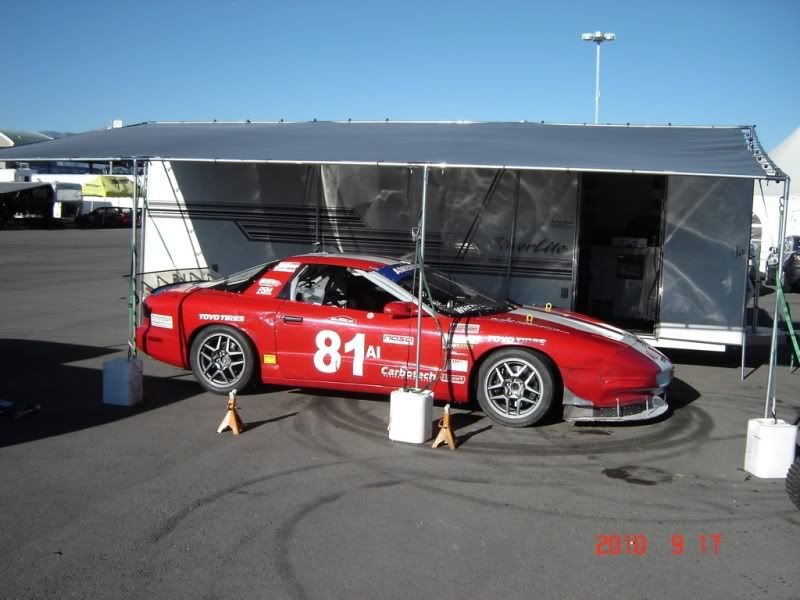

Edit:love the 3rd gen. Just some of my toys
http://img.photobucket.com/albums/v635/firehawkclone/a6df88a4.jpg
http://img.photobucket.com/albums/v635/firehawkclone/fff86e75.jpg
