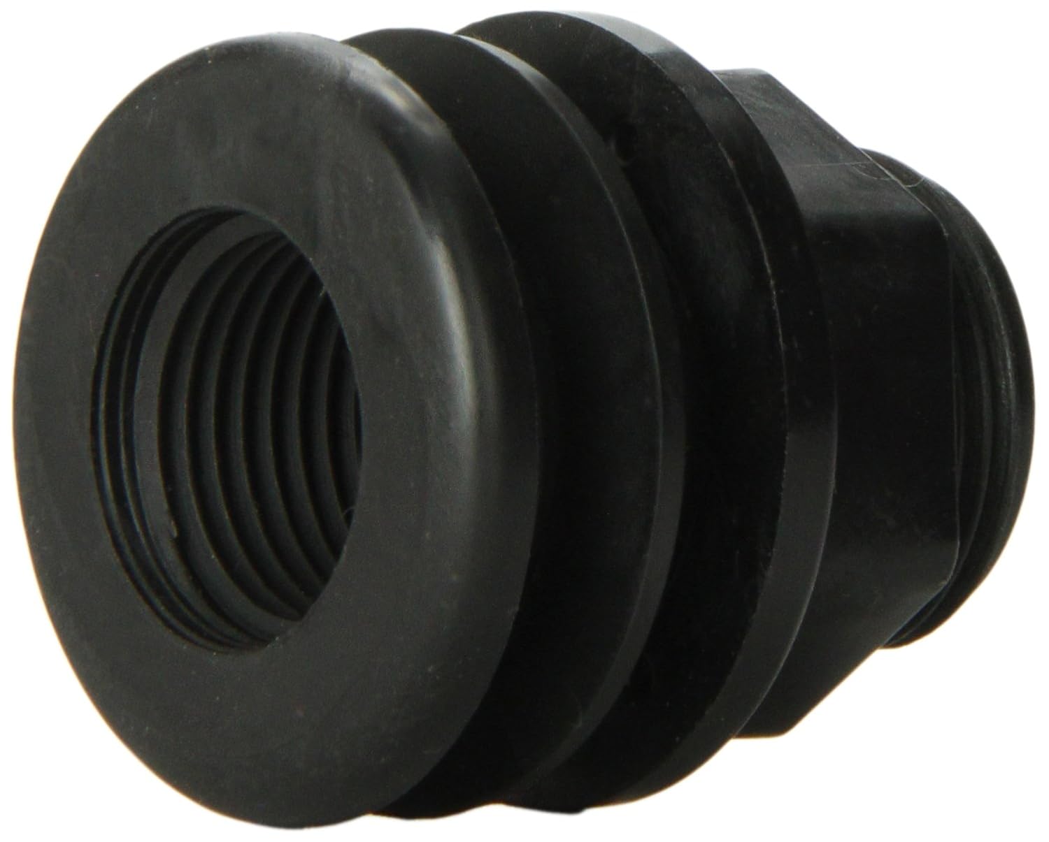

I bought one of these "threaded bulkheads". I plan to install it in the bottom of the jug and pipe a line down to my sink. They are meant for aquariums, but should work fine for my application I think.

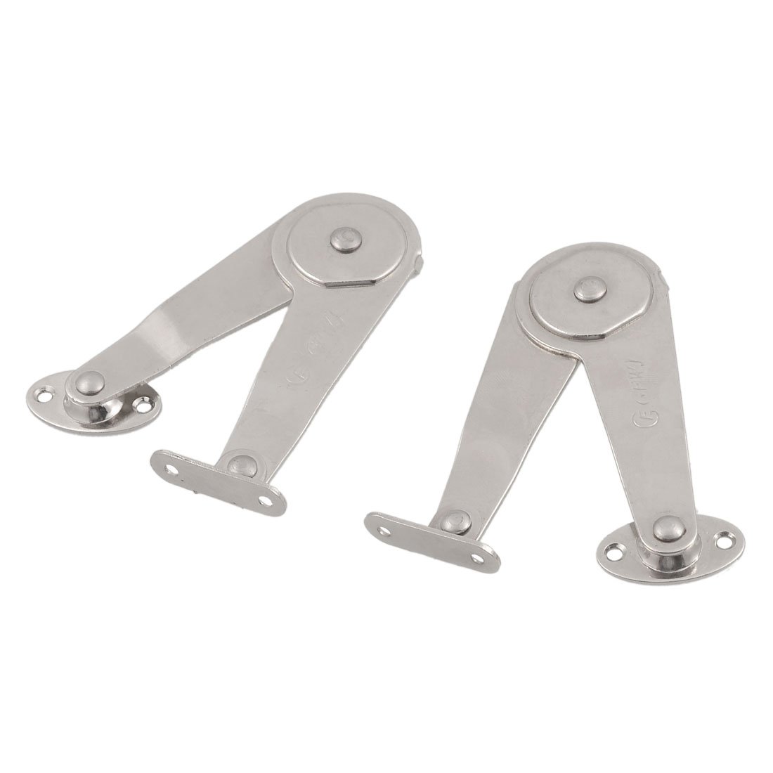

Made a hold open for the pantry lid. Tried some of these that I had, but they couldn't hold open the weight since they are really intended for a drop down desk:
Instead did this with a "barrel bolt" (like you put on a cabinet or door) I had laying around. works fine

Drilled the tank, mounted the tank/jerry can holder on the outside front of the kitchen box. Having trouble securing the drain bulkhead fitting inside the jerry can, since I have to do everything through the 1.5" cap opening in the top. I have the hex nut onto the inside threads of the bulkhead but I can't think of a way to hold it tight enough to tighten it and get the gasket on the fitting to seal against the outside of the can. Don't have any pliers long enough or a socket big enough for the hex nut.... hmm.
