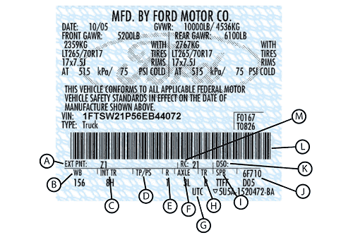

I took another look at the original catalogue for my truck and was unable to determine what gearset it has. I know the Hvy Duty Payload Pkg came with 9.75".. My truck does not have that package. I do have the Max Towing Pkg but the details for that package does not reflect the gearset.

There is an axle code on the vin. Probably L9 or L6.

Just checked the VIN# and no "L" showing. Also no place where a single numeral follows an alpha character.
On mine the axle code is located inside the driver side door on the B pillar where the other info like GVWR and axle ratings are located. At the bottom of one of the stickers there is a one row table. One of the columns is "axle". I have an L6 there.

Sorry. That wasn't a clear explanation. There should be an axle code on the door jam.
Do you have an open diff? No locker or limited slip in the rear?

The door jam sticker shows L9 for axle. The FX4 pkg and the Max Tow Pkg both specified the 3.55 electronic-locking rear axle.

Max Tow will come with 9.75”.
In fact, I believe all 3.5 ecoboost comes with 9.75”.
I found the reference on the B pillar post on my F150 showing Axle L9, which I guess confirms the 9.75”. Learn something every day.
