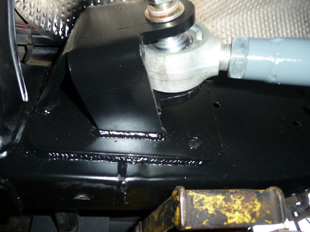

keep an eye on the rear upper link mount at the frame. after doing a similar 3 link on the rear of a 4th gen 4 runner, the frame does not hold up to abuse very well. i see that the bracket is plenty beefy, but the frame is not plated.
i am in no way saying anyone did anything wrong, or that i am right, just some helpful info that we learned the hard way.
again, sweet build!!
FJLED
Good eye. Usually I'm better about not posting mock up picks, but I now realize I tossed both upper link mount photos on there when they were only tack'd in place. Axle mount has gussets in some of the photos, but I never tossed up the final photos of the frame side once we got the geometry set.
Perhaps you were recommending something along these lines? :beer:
Nice eye nonetheless. Hopefully it will hold up a bit better than the 4 runner frame did. Probably only be in place for a year or two. Phase II's already under consideration (triangulated 4 link, F9 or dutchman front, front moved forward a few inches, rear moved back an inch or two, roll cage, fuel cell, possibly a custom front IFS...still trying to fully understand the geometry and steering...hopefully have an excel calculator developed in the end after a bit more reading). Let me know if there's anything else that catches your eye or think there's anything we might have overlooked. Definitely appreciate it.
Just some notes on the other items you might key in on. Cam tabs will be boxed when we get the alignment in order, the rear coilover towers are built into the frame right at one of the crossmembers on the frame (don't think there should be too much of an issue there), and the jounce shocks on the rear will end up having a strike pad on the axle.​
