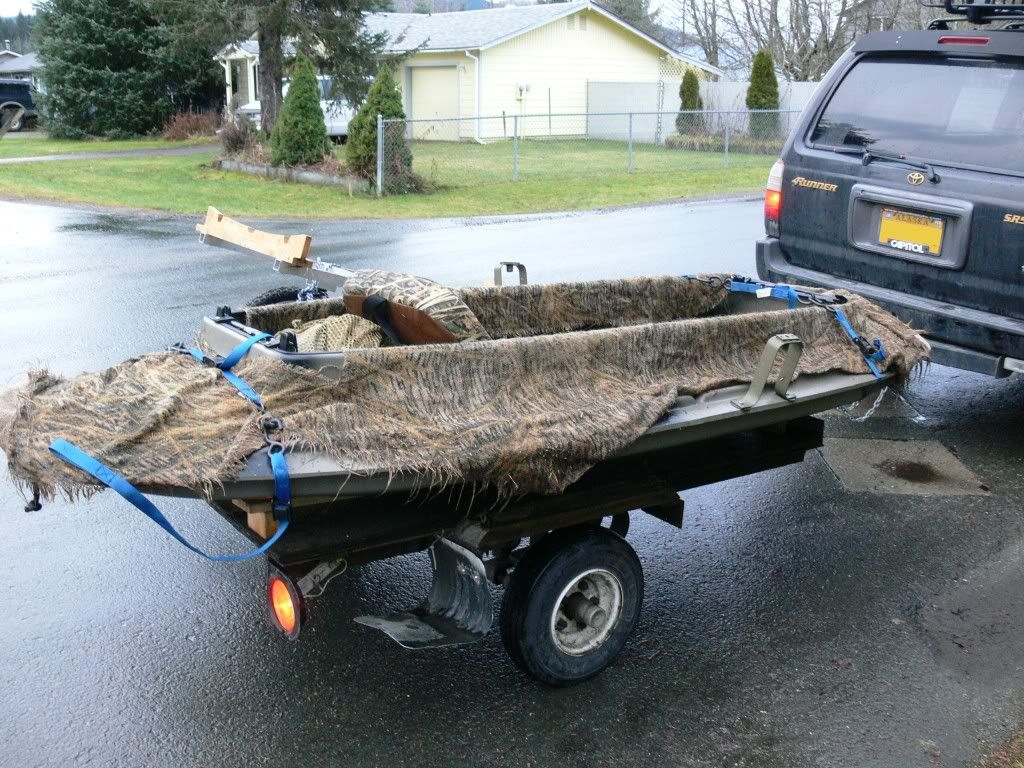

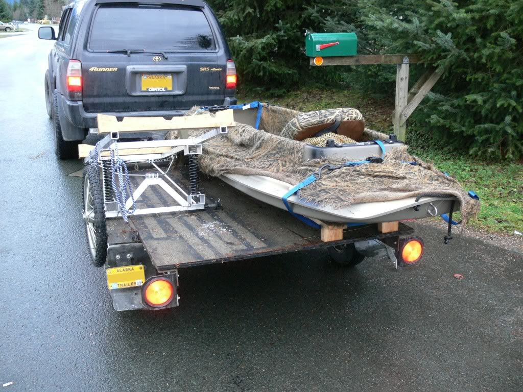

I'm interested in ideas for an off road flat bed trailer as well. I have a tiny flat bed I use for duck hunting and utility purposes that I want to replace with something larger and with a real suspension.
Here's my current set up.
