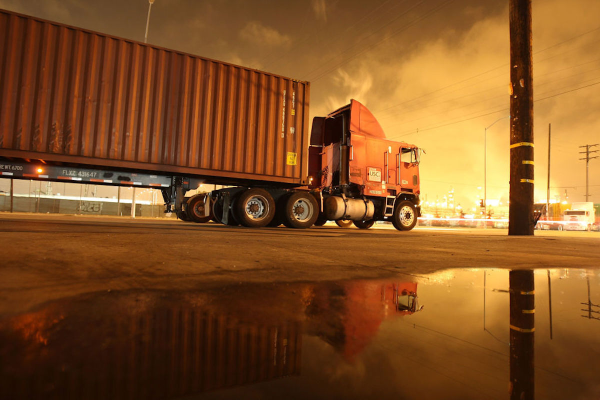

And don’t expect to be able to drive that big rig ⬆ in California if it’s an older diesel burning truck (with weight >14,000 lbs).
And that big ER you own? Yeah, that not gonna fly in California any more either if it’s earlier than a 2010 model…
lucilius
Any CA residents/others familiar with this rule? It appears to apply to CA truck&fleet owners with a truck(s) over 14k lbs that are older than 2011 model year? I foresee some extra space in the National Parks and other tourist locations if they enforce this on all campers traveling into CA.
