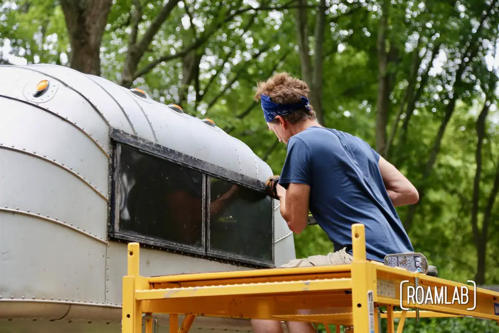

This is the only example I've seen of someone trying it... an old Avion camper that originally had a sliding window in the nose. He (or she?) links to it elsewhere, and it's a Maygood window. He said it actually did leak when he first drove in the rain, but that might have been because he'd failed to remove a piece of plastic. I didn't see any mention of the window in later posts.
