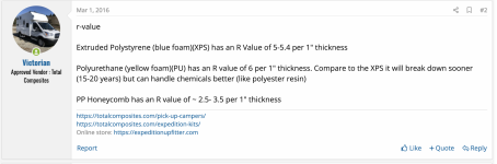

As for insulation, my current camper is HC and the insulation is not virtually zero. But I'll defer to the experts:
When I was investigating, I couldn't find a reliable R value for the HC. One important factor is that "per inch" doesn't really work because the cells are so big that air circulates inside them pretty easily, and transfers energy from the warm to cold skin. That still gives you a little resistance, but...
