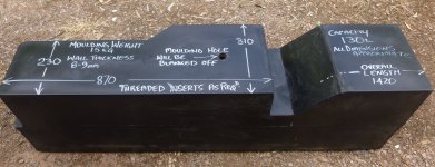

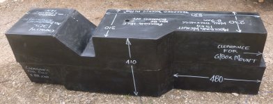

I make my own plastic water and diesel tanks.
Well, I actually make the moulds from sheet metal and have a local moulder mould them for me.
The process is "rotomoulding". Powered MDPE is placed inside the mould which is then rotated through 3 dimensions inside an oven. The powdered plastic melts and deposits itself on the inside of the mould. When it has all melted the mould is cooled slowly and the plastic solidifies before the mould is opened and the part is removed.
All sorts of variations can be employed. Fancy moulds can be made from thin walled cast aluminium, threaded inserts can be moulded in, there are material choices and any colour is possible.
Canoes can be made using similar methods.
This is a great process for low volume containers. The material is inherently very tough and it can be moulded in virtually any thickness. Threaded inserts can be spin welded into the tank anywhere they are needed after moulding.
It is totally inert to the effects of fuel although gasoline (not diesel) in Australia usually requires a cross linked version (which is a bit more expensive and harder to mould) for legal reasons.
The prime issues with gasoline is the permeability of the plastic. It "seeps" through, so barrier layers are needed to reduce the minute losses.
There are no "seams" the part is made completely hollow as one piece. What look like seams are the joins in the mould, not the part.
My current vehicle has DIY rotomoulded tanks for diesel and water that are now 20 years old. They have zero additional stone protection. The pics below are new tanks for a vehicle currently under construction.
I am making tanks between 60L and 200L, typically with wall thicknesses of 6mm for water and 10mm for diesel. The vehicle will carry almost 400L each of diesel and water, all in DIY tanks.
