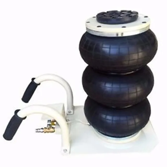

Also, speaking on items from the commercial wrecker/tow industry, I wonder if anyone has tried the air-bag type jacks for the full size trucks. I don't mean like the ARB pillow-type air bags, but rather the compact air bag jacks like the one pictured below. They don't weigh a tremendous amount (at least not appreciably more than a suitable bottle jack) and probably are quite a bit quicker to deploy.
Any thoughts?
