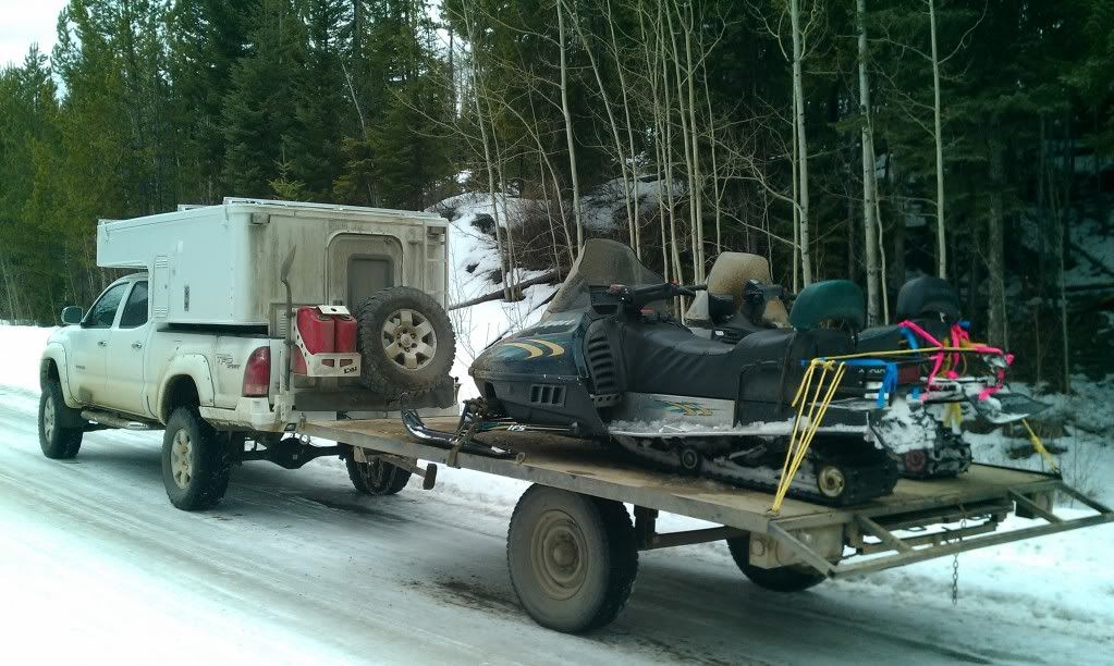

I think it depends on what types of terrain you plan on travelling. Having owned a Tacoma with a Phoenix Pop up which is not all that different the a FWC.....perhaps a bit heavier due to the options. I can tell you I upgraded all suspension (6" lift), installed air bags, re-geared to 4:56, chipped, exhaust and air box mods and upgraded my brakes and eventually it was okay. You'll be fine with just the camper and keeping the weight down with a Tacoma....obviously over the GVW though.
Then I threw on a trailer with two quads or snowmobiles and it was not. I did love the truck off road though and if you plan on doing Jeep type trails stick with a Tacoma....if its over landing where you will be primarily on rough FSR's etc I think the Tundra is a better choice. For 80 % of the time I prefer my Tundra. Pulls it all easy, lots of room and stops it all easy.....but its too big for most trails (th2 20 % of the time I wish I had my Tacoma still).
