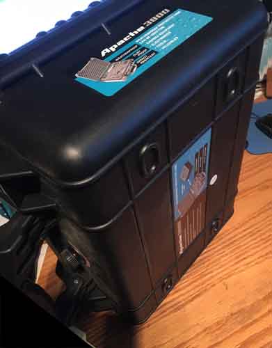

the bottom / back of the Apache 3800.
If you are using standoffs it would be easy enough to cut in some sheltered ventilation in the back side. Screen mesh. You could even use those in-line mesh screens for hose-connected drip irrigation systems. Breathable but screened from insects.
