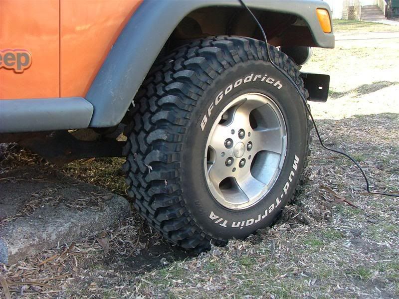

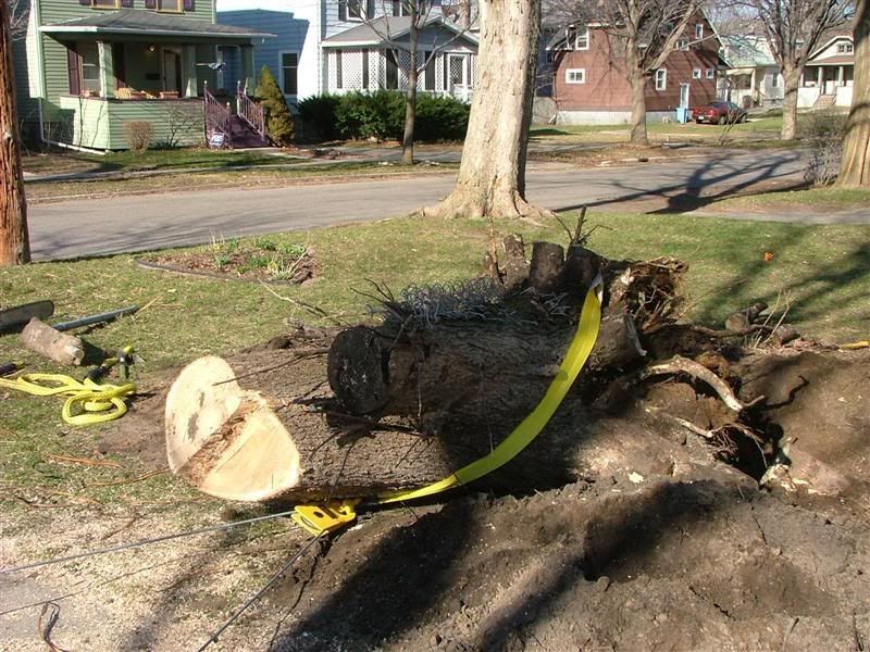

Anyway, my $529 M8000 successfully pulled my TJ and Opie's Chevy Colorado across his neighbor's yard with breaking a sweat, while we were trying to remove a stump from his yard today. Even after we re-chocked the wheels, it still dragged mine (wheel chock included) through the dirt. The winch didn't even get warm, never made funny noises, and did finally pull the stump out.

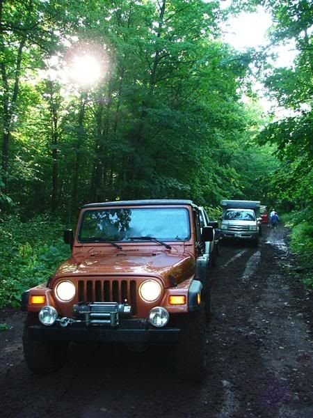

I think I might would speed the money on the Smittybuilt XRC8 winch. I know 4 Wheel Parts was just running a special where it was shipped for free so you got an 8,000 lbs winch for $299.
I know normally folks say Smittybuilt is the bottom but I have seen quite a few of those winches on the trails making long pulls and/or several pulls with no issue. One of our club members has the old (slow) version and has used it for awhile and it is still kicking. The newer model they sell now is much faster than the old.
