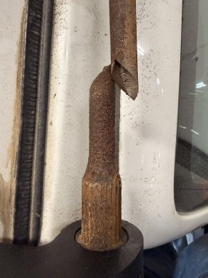

I have been getting water ingress into the cab of the Jeep so I decided to re-caulk around the hinges. On the first camping trip since re-caulking I noticed the hinge moves a large amount relative to the fiberglass clam shell. I tried to tighten the bolts on the clam with the roof only partially opened but they were already as tight as I could get them. I also noticed the epoxy on the clam shell is cracked nearer the hinge side on both driver and passenger (this area is hidden under the skirt on the portion of the ten over the hood). Is anyone else seeing this behavior on their habitat? (photos attached in the closed and open position, note the gap in the caulk thats not there when closed)
View attachment 739166View attachment 739168
I have had the same someone in another tread said that Mario told them to silicone the whole area between the top and windshield gasket. They advised they have not had any leaks since. I will be doing the same soon.
