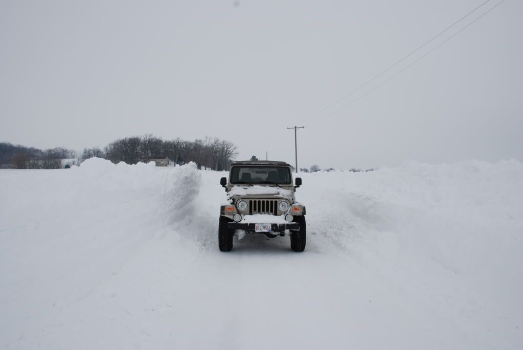

Here is a couple of photo's after a major storm back in IL...
Notice the glove to the right in the first photo:sombrero: Went through there the previous day, snow was coming over the hood so fast I could only see out a 2" opening at the top of the windshield, knew if I stopped I was done so I kept my foot into it using the telephone poles as markers... yee haw:wings: Jeep felt like it was floating on a cloud, wish I had her back:(
