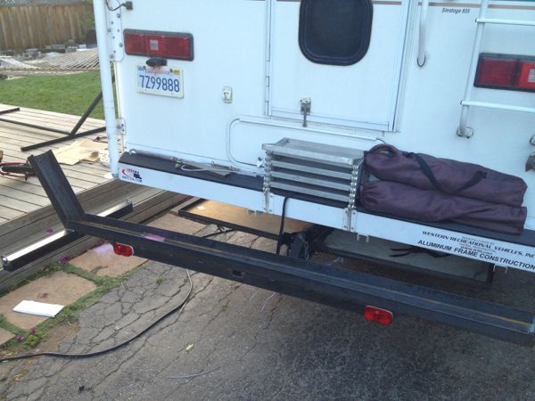

I fabricated a rear hitch rack to carry my bike because my (125lb) spare tire is mounted up front...

Mark, how do you access the camper once the bike is loaded? do you unload the bike? If you unload it, how long does that take?

msiminoff
There's enough space between the camper and the bike to open the door about 45º, so there is plenty of room to hop in if I need to. I frequently load and unload my stuff (clothing, gear, food) without taking the bike off.
Once I get to camp unloading the bike is fast, probably less than 5 minutes; Lean the ramp against the carrier, loosen the (3) tie downs & the lock, and roll the bike down the ramp.
