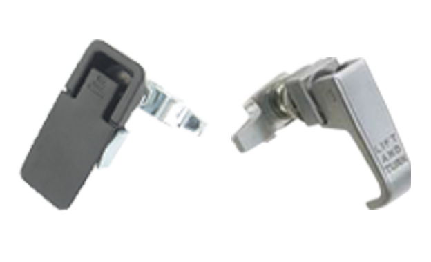

I have used all sorts of latches and locks to keep the doors of my cabinets closed even on bad or very bad tracks or off road. The only ones that worked reliably were the southco latches https://www.southco.com/en-us/c2 .
Peter_n_Margaret
The spring catches that I pictured earlier work very effectively on the "short" doors in all off road conditions, but are no good on conventional full doors where I use compression latches similar to those you link to. With all but smaller doors I have usually used two per door. The doors are all sandwich panel.

We had no luck with those C2 compression locks on the bigger drawers, ended up replacing them all with these.
There is a zinc metal part that wears on corrugations, and then they just let go. The ones we replaced them with are an exact fit, but with a positive quarter turn latch
