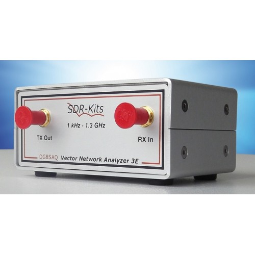

Nice. What hardware did you use for that? I’ll buy an antenna analyzer one day, just curious what people are using.
I used a DG8SAQ network analyzer. I own a VNWA3E model, handy little tool.
DaveInDenver
Middle Income Semi-Redneck
man why does all the cool ham crap require windows.. :(
Yeah, in this case there's really no way around it for their tool. They do have Linux software although I have not personally tried it. I think it just uses WINE, though.
If I was buying one now it might something like a pocketVNA, which also has Linux and Mac software.
But I gots what I got and spending $500 again isn't happening. Unless someone with Windows wants to buy my VNWA...
