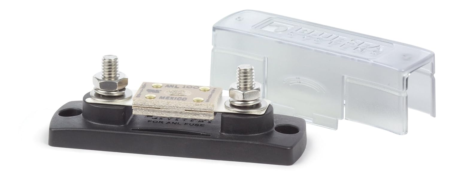

As long as you have the breaker though, if the controller fails or something happens, the breaker will trip and it won't keep sending power into the system. You probably won't need more than 30 Amps. Search Blue Sea Systems 285-Series Surface Mount 30A Circuit Breaker - depends on how many amps you expect your charging system to actually send out. My ground deploy can do 25 amps, so I have a 30 amp there and the other one is rated at 40 amps thus I have a 50 amp one. Because anything more would be an indicator that something is wrong with the system, like really wrong. ;)
For the inverter, I am calling it the wrong thing: this is what I'm talking about
Blue Sea Systems ANL Fuse Block with Insulating Cover - 35 - 300A
Blue Sea Systems 5133 300A ANL Fuse
Depending on the size of your inverter there you can go even bigger or smaller on the Fuse block and the fuse. Just depends on the amperage you expect.
I added these up including 1 mini-knob all Blue Sea on Amazon, about $112.00 worth of cost. You could replace the components with cheaper brand.
For me though, the breaker and a master on/off would be the must haves of the system.
