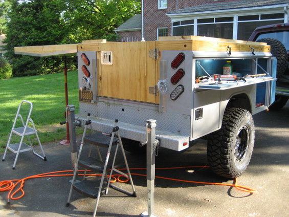

Hi-Lift bar & foot for rear stabilizer legs?
elmo_4_vt
Valid point. I like your set-up, BTW. What model/part # did you get for your jack? I have been trying to find a site that details the differences between all the various Bulldog models, but never did find a manufacturer site for them.
Craig
From the Fulton post, looks like I have model #195354 from THIS pdf.
I thought mine were 3000-3500lb models, but can't be sure... They work great, but are heavy.
RagnarD
They really do work great:
Pull one pin and they slide off for other uses. A clevis keeps them raised for travel. Pull the clevis pin and jack up the trailer.
Mine are mounted to a bar that is part of the rear hitch framework.
It looks like you have a piece of pipe that slips over the jack bar to help stabilize it. Do you have any more pictures?
I have an idea how to attach the lifting hook to the trailer but would like to stabilize the top of the bar to take some of the wiggle out.
