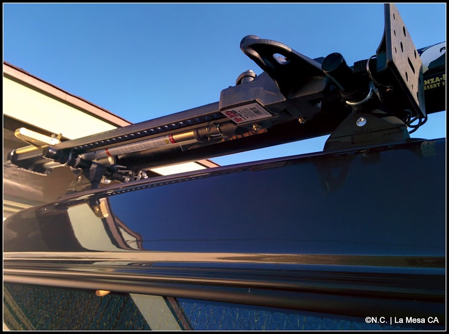

@kevin108 I'm interested in how you mounted it with your RTT? Looks pretty cool and I'm currently trying to come up with a solution for mounting mine.
outofrshell
Grand daughters Trooper I fixed up for her, it is on a swing out I later adjusted it to sit straight
My Trooper, I carry the mechanism inside. Not a great picture but the jack bar is the green bar behind the license plate
Kevin108
I used Hi-Lift's own mounts, the TM-700. They run about $50 on eBay, but there's better pics at https://www.amazon.com/dp/B003CEODQI
I definitely could have made my own mounts, but I was buying all this stuff while recuperating from arm surgery, so my physical activity was severely limited - so much so that I made a cardboard cutout of the jack to determine placement of the mounts because my arm wasn't well enough to lift the jack. :D
A lot of people have made a similar mount with the far more affordable ballast clamps, but I hadn't learned of them yet when I bought what I used. http://www.ebay.com/itm/330955747614
