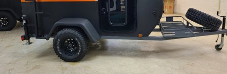

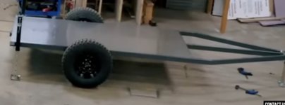

Hope I am not beating a dead horse here and I am not a chassis engineer. If you look at the following pictures I just wonder if there should be a cross member in the A frame. Plz correct me if I am wrong.

Isn’t beating a trailer to death an expected level of use for an overland trailer? With other builders offering lifetime chassis warranties, no way would I touch one of these.
