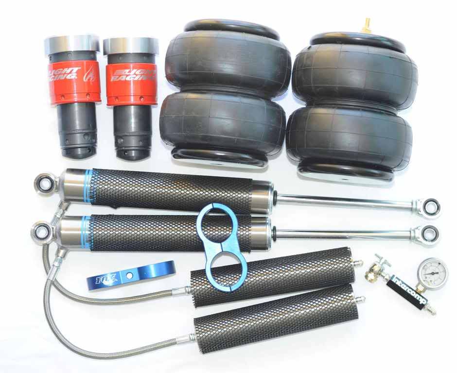

Just if it helps anybody, I built a custom trailer using a known manufacturer's swing arms (local here - and from what I've seen of how they manufacture them there's no way I would try to replicate that in the shed!); and these airbags, these shocks (remote reservoir and 8" travel), limiting straps and hydraulic jounce shocks, which I haven't seen anybody else use on a trailer yet. They're in front of the straps out of sight in the paint-stage photo. So far so good, been over some rough country in the last year and all good. Still figuring out the ideal air pressure for the bags but so far it's lower than I thought, then a bit lower again, and maybe still lower than that. The trailer weighs around 1200kg loaded (2600lb)ish.
