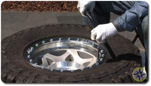

The hard core guys know this but have you ever wonder how beadlocker wheels work or how you mount tires on them? Here is a how to video and write-up showing you how we did it... no fancy tire shop... just the tools you carry on expedition (or should) and a little brute force.
mounting tires on beadlockers
